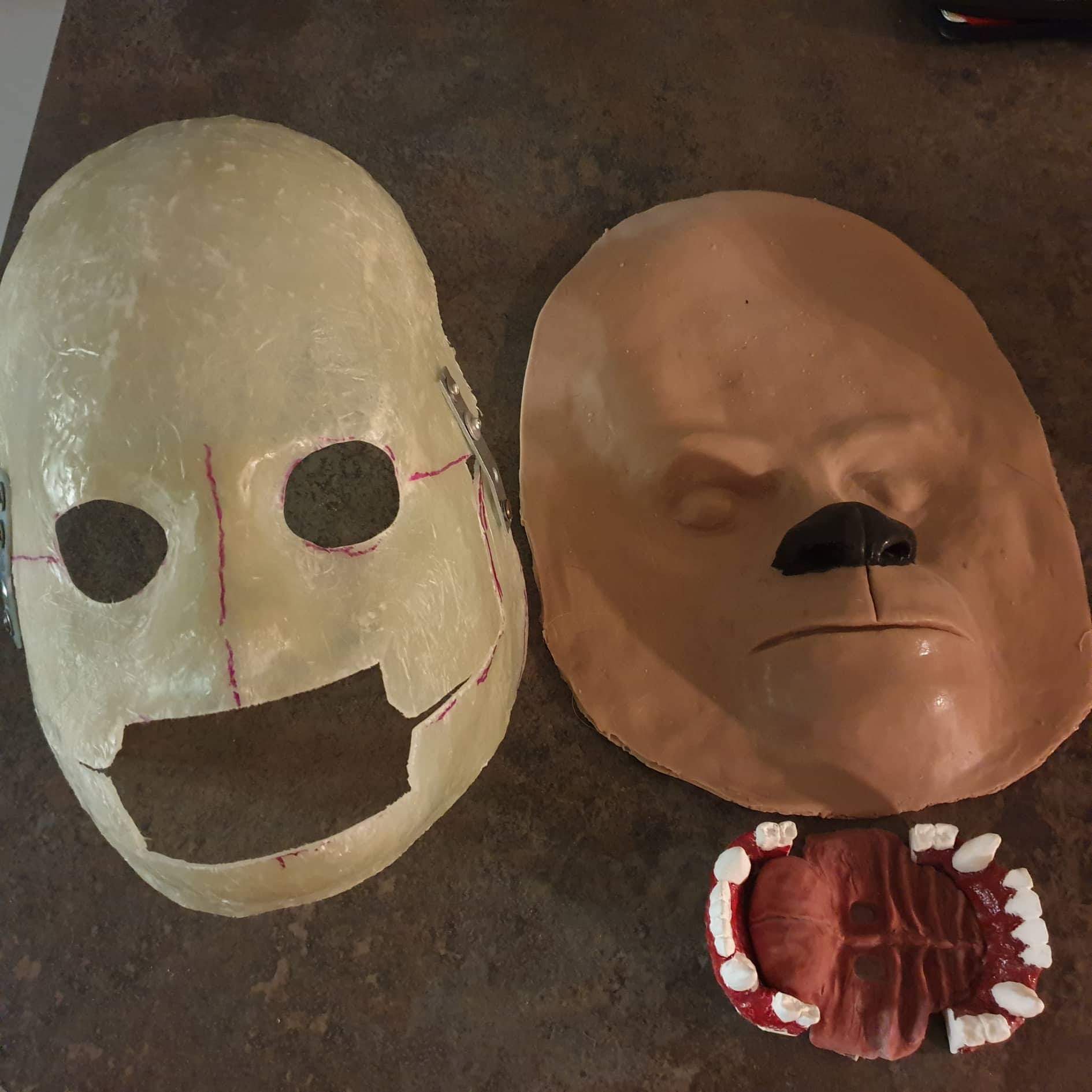

Thought I’d put this WIP together for any prospective Wookiee builders.
Generally if your going to build a Wookiee, you’ve got three options when I comes to the mask.
1. Commission a complete mask from one of the expert builders such as Chewbacca 5.2, EvilChimp FX or Paul Humphries. The benefit of this is you’re going to get a cracking mask from someone with loads of experience. The downside is they’re not cheap and depending on orders you could be waiting a while.
2. Purchase a mask kit and build it yourself. The pro’s of this is it will save you a bit a cash, the satisfaction that you built it and the enjoyment of the actual build process. There aren’t really any downside although it may take a while to achieve the quality of those expert builders.
3. Build it from scratch. There’s a lot more involved with this as you have to create a cast for your underskull, create a cast for you mask/face out of clay etc. Generally if your going down this route then you’d be looking to start offering your own kits to recoup the effort.
So for the purpose of this wip we’re looking at option 2. I purchased my kit from Paul Humphries and it consists of the fibreglass underskull, latex mask, teeth and tongue. I made a few Wookiee mistakes but got there in the end.

The 1st step was to assemble the mouth. My teeth arrived unpainted so I painted the gums with some Tamiya acrylic red paint I had lying about and left this to dry.
Next once dry, the silicone sealant was applied around the edge of the teeth and this was attached to the tongue and clamped together with light pressure and left to cure for 24 hrs.

Post by Larphitupfuzzball » Mon Mar 02, 2020 7:26 pm
Attention then turned to the mask itself. The alignment was checked with the slot cut in mouth
Silicone was then applied to the underskull
And the mask placed on the underskull and allowed to cure for 24hrs
